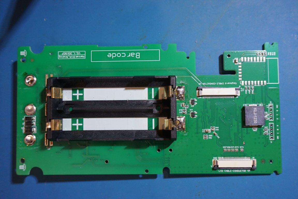

The internal layout of the 1833C is considerably cleaner compared to the 2D72 given that the circuitry for an LCR meter is much simpler than an oscilloscope. It utilizes a two-PCB design, one is the keypad board (see below) and the other is the main PCB.

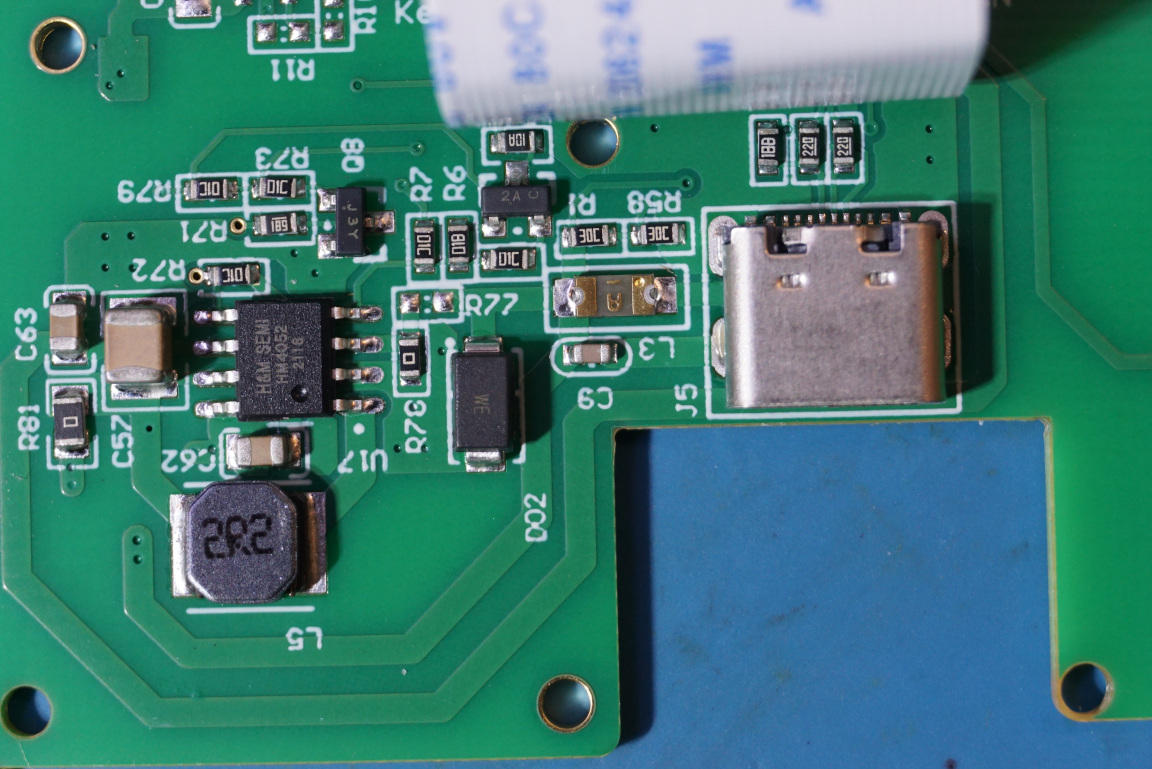

The only active circuitry on the keypad board is for battery charging. This is accomplished by the HM4052 charging controller.

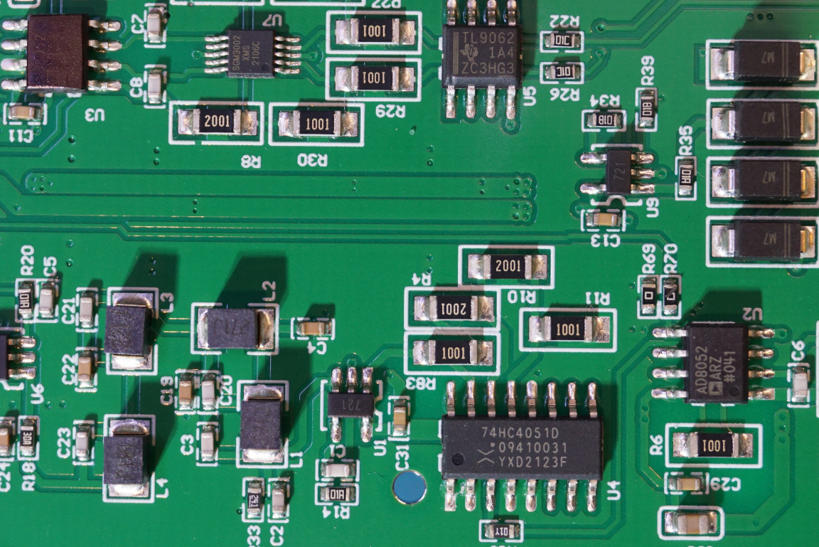

Here are a couple of pictures of the main PCB. Like the 2D72, the 1833C PCB also has a foot print for an SD card but that footprint is unpopulated.
The main processor used in this LCR meter is a Geehy APM32E103 ARM Cotex M3 compatible microprocessor.
Other components include TL9062 Opamps, AD8052 high-speed Opamps, 74HC4051 mux and SGM3002 SDPT analog switch ICs.
It is clear that all the major functionalities are accomplished by the MCU given the supporting circuitry we see.
