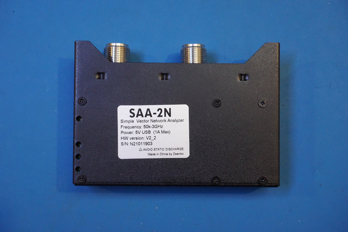

NanoVNA SAA-2N Teardown Pictures
I received yet another NanoVNA for review. This time it is a S-A-A-2 (NanoVNA V2) with N connectors instead of SMA connectors found on the other NanoVNAs I reviewed before. This NanoVNA is based on a fully open-sourced design, with schematics readily available. Compared to the NanoVNA-F V2 I reviewed a while back, the specifications are very similar. This VNA is capable of sweeping between 50 kHz and 3 GHz. The LiteVNA I reviewed last time has broader frequency range and is capable of scanning up to 6.3 GHz.
Unlike the other NanoVNAs we had done teardown with, the SAA-2 utilizes a two-board design with two PCBs stacked together.
