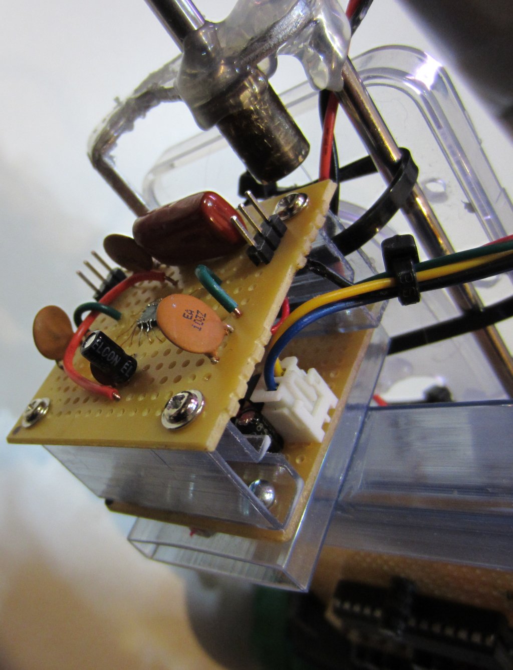

Here are a couple of pictures of the finished IMU boards. I used two small protoboards, one for the accelerometer and the other for the gyroscope. They are stacked together using sections of anti-static IC tubes.
Depending on how you are placing the accelerometer and the gyroscope chips in your design, the axes you use will differ. Both of my accelerometer and gyroscope are mounted upside down using the soldering technique I have been using for prototyping. So given this chip arrangement, the y and z axes of the accelerometer and the x axis of the gyroscope are used (more on this next time when discussing the code).

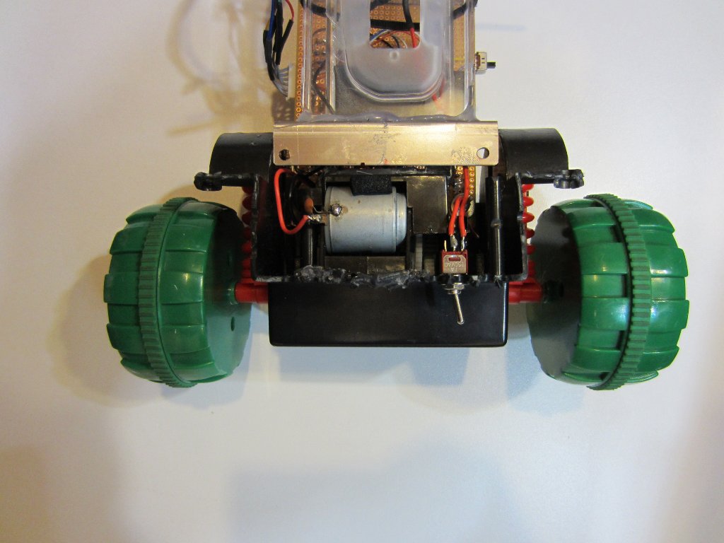

The toy truck I used for this project has a single motor that drives both of the rear wheels. Since I only need the drive wheels, I cut off the unused front portion. The toy car’s plastic chassis is not rigid enough so I hot-glued a few pieces of plastic and metal support on the back. The extra support is important as excessive vibrations affect the accuracy of the sensor measurements.
Here is a picture of the finished robot:
I used a rod to extend the height of the robot to roughly 16 inches and placed the battery pack (4 AA) on the top to increase stability.
