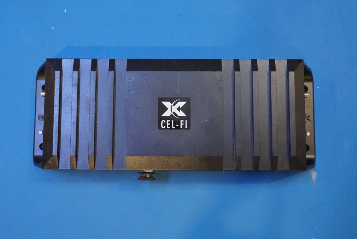

So I was excited when I got my hands on another identical used unit. And this time around I was going to to do an extreme teardown and take a deeper look at the unit.
This used booster looks a little beaten-up from the outside. The only slight difference between this one and mine is that on each of the mounting bars there is a mounting screw, although it could have been added by the original owner.

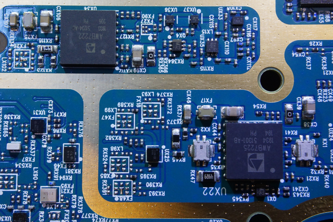

Now moving onto the uplink section which communicates with the cell towers. As mentioned earlier, this section of circuitry bares a lot of resemblance to that of the downlink section.
The AWB2222 chip you see here is another Skyworks power amplifier chip, which operates on the 1.805-1.880 GHz frequency band.
Here you can see a couple of unpopulated sections, again these are likely reserved for other frequency bands.
In the picture below, you can see two more Skyworks amplifiers. One is a 7222 for the 1.805-1.880 GHz frequency band. The other is an AWB7225 which covers the 860 MHz to 894 MHz frequency band.
Here is a picture zoomed in to the bottom left of the uplink side of the PCB RF section.
Like the down link section, the uplink section also utilizes two ACP chips.
