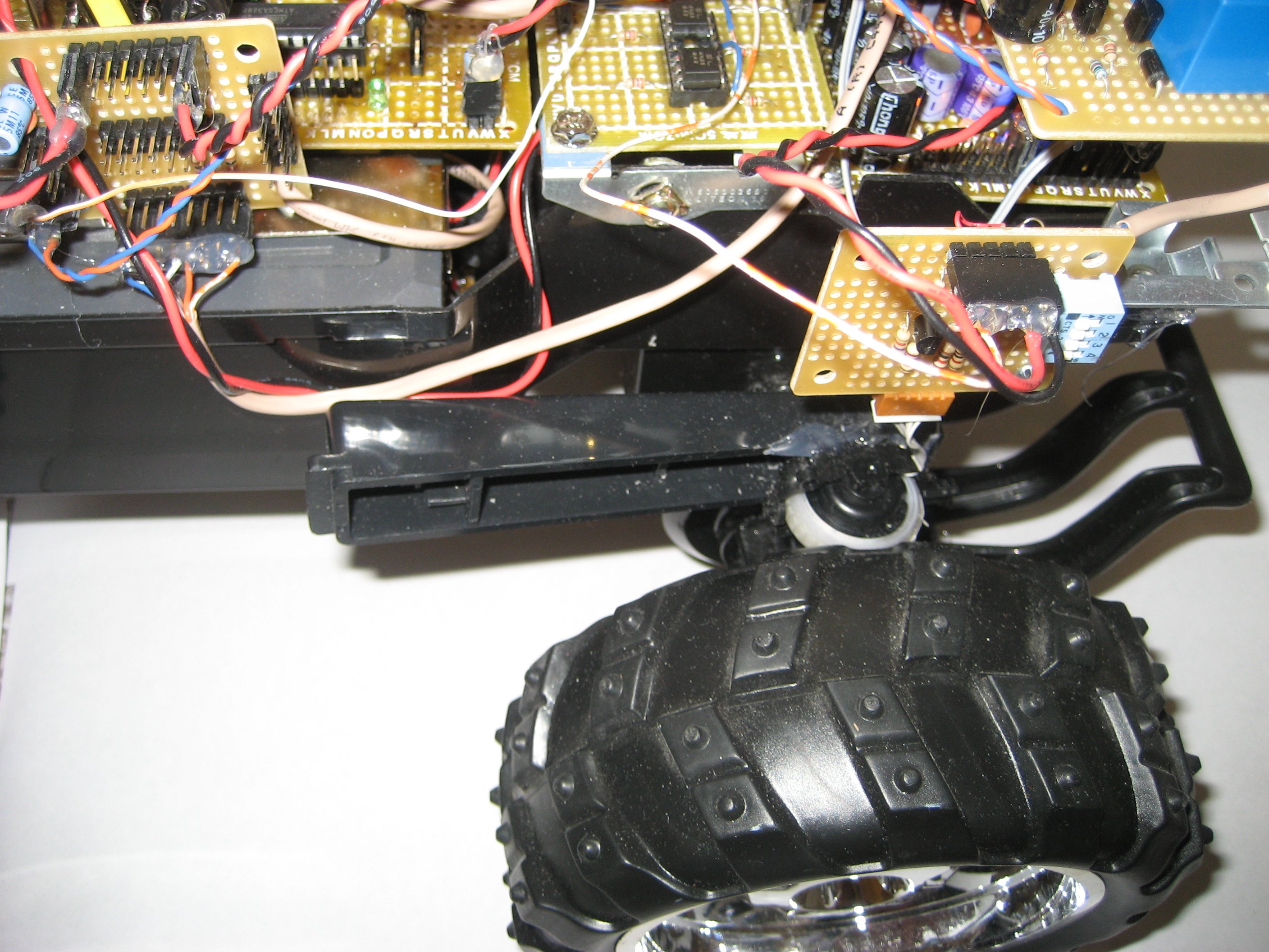

I have so far added a simple front wheel encoder and a more complex rear wheel encoder to my vehicle platform. By using these two encoders in conjunction, I can obtain vehicle acceleration/deceleration, speed and skid information. I modified the original remote control circuit to allow controlling via remote control or the on-board MCU. This dual drive configuration also allows PWM signals to be used to drive the gearbox and thus achieves speed control. An ultrasonic range sensor (I, II) is used to detect obstacles in front of the vehicle.
Here are a few pictures of the platform I built so far:
Side View (Left)
Side View (Left)
Side View (Right)
Side View (Right)
Top View
Top View
Rear Wheel Encoder
